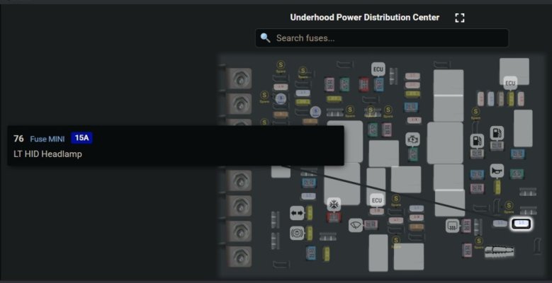

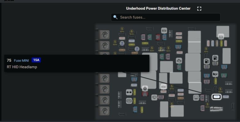

If your truck has HID headlamps.
Seems really weird that both sides went totally out same time. If fuses good, maybe that headlight switch has a short? Just throwing stuff out there. Both sides go out together, short in headlight wiring before the lights? Weird. Maybe OP get lucky and replace both fuses and wala, let there be light.
