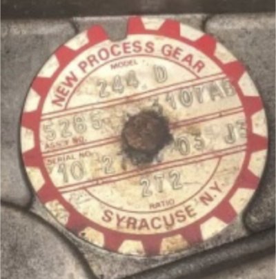

Not to sound like an ****** like some are, You are sure about that model of t-case ?
Look on back of case you will see a round tag, That tag will have the t-case model number,

yes, absolutely sure…the round tag indicates 244D

Ok now that being said, watch out I just went through some BS with my kids truck 2004 Ram 1500. his case had 243 D
found a case on market place out of a 2011 ram with 243 D however the e-shift connector was wrong. We now have a t-case for sale.

Any possibility that some previous owner installed an incorrect transfer case?
If the 244d is a Durango/Dakota case, it would make sense that it eventually exploded.
