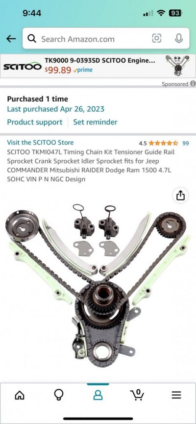

Here it is. My grandmother went on and ordered the timing kit from Amazon. She entered all the info as correct as she could and checked everything was correct to the best of her ability. We also went and got a camshaft sprocket from the dealership that matches perfectly with the one from this kit

Yea looks like the right one good chance timing is just off a hair on one of the cams normally will run weird if its off a 1-2 teeth. If you wind up pulling valve covers set it to DTC with the mark on the damper and take a pic of both V8 marks on the cam gears did you do a compression test?
