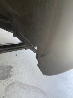

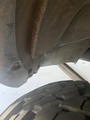

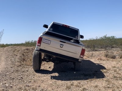

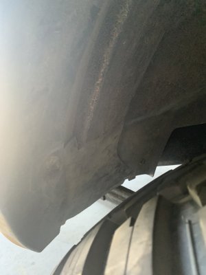

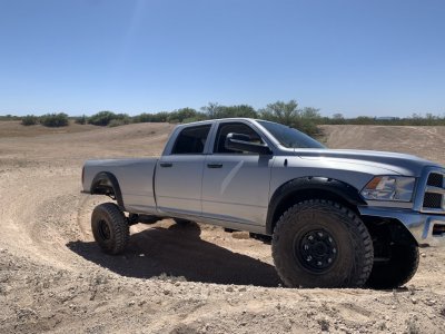

Those monster truck tires look great! Did you have to do any major fender/bed trimming like you need for the AEV fender flares and any suspension mods for the 39's? Looks like you are getting plenty of flex there.

I’m on Thuren 3” lift. Haven’t done anything to the rear. Just a slight slight rub that’ll prolly self clear after a few trips. The front yeah. I cut and trimmed quite a bit. I run -offset wheels so I get zero rub on radius arms or sway bar “when it’s on” but had to clear quite a bit of lunch weld and liner. But I have no rub on anything in front end lol. I don’t mind the extra work and the aev flares look too big to me. I just cleaned up my liners with some old rear liner and plastic clips. It’s had to tell much has been done. You gotta look at it pretty hard.
