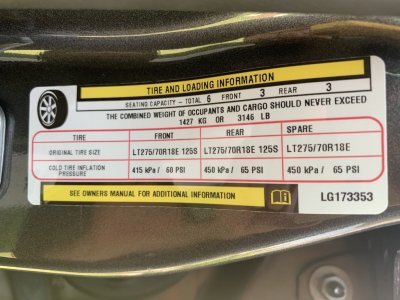

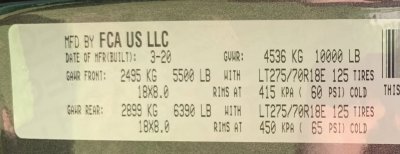

Once you go heavy duty....you never go back. I picked up a 2020 2500 Tradesman CC 4x4 with the Hemi and love it.
These are the payload, GAWR and GVWR stickers from my 2020 2500 Tradesman 4x4 with the 6.4 Hemi.
3100# payload is amazing. Max towing is 14,280#
The GCVWR is 24,280#

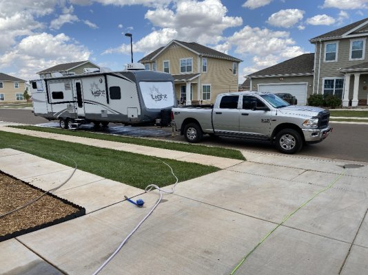

Nuevo Mexico
My trailer shown above is 8500# dry and 850# tongue.
After it’s loaded and set up it’s 9998# and 1400# tongue. 2500 with 6.4 was the way to go.
2018 Ram 2500 6.4L 4x4
Amsoil SS 0W-40
