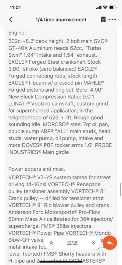

Ok. Thanks again. Ohh and to your comment about emojis and not readable...Not sure what the hell you mean and honestly don’t care. It came out fine on Tapatalk. If you can’t understand the picture below showing what was typed for the upgrades on the mustang. It’s ok.
Next.

Thanks man. Not sure why that came out that way and yet I still don’t see that.
I just copied and pasted what was used in the ad I posted when I was selling the mustang.
I’m sure this thread will get lost and get derailed in every direction....ohh well.

What 57 posted is what the rest of us see,and it's not all that easy to read. It lost something in the translation from your add to your post,lol.
