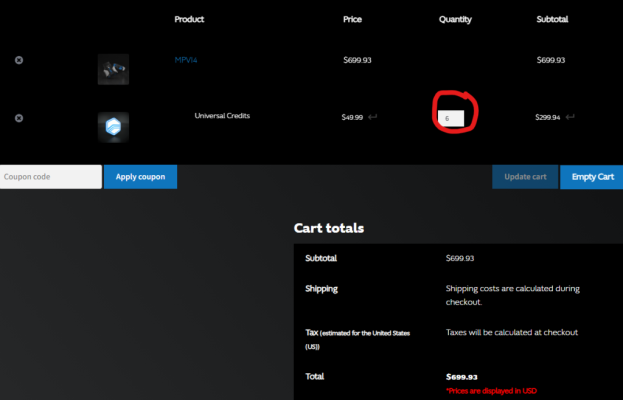

This is what you'll need. Lucky for you, your PCM doesn't need to be unlocked. Buy this in the picture, buy the tuning service (my recommendation is FRP), and get to tuning.
Thank you for contacting HP Tuners. We offer custom tuning software (tools) that the professional tuner shop or hardcore enthusiast uses to create their own custom tunes. While the MPVI4 (which comes with VCM Suite, VCM Editor, and a programming cable) provides full tuning support for your vehicle, it does not include any base/canned tunes, nor can we provide any specific guidance when it comes to tuning. Below I have provided answers to our most common questions.

The MPVI4 comes with everything you need, minus credits. The device, cable, and software (tuning software and scanning software) are $399.99
That is what they sent to me.

Your ecm (ecu, whatever) already has a tune on it. You use the HPT to go in and edit it to how you want to work with your new cam. Or you can find people online who you give them your specs and they will make a tune for you that you then upload with your HPT.
Got you, going to check some videos i found online and get into the hp tuners forums to check it out. thanks for the update.
