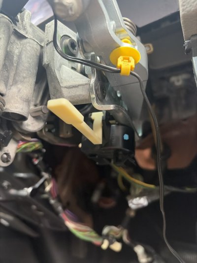

I seem to have power to all relays that have to se with the starter and they click while cranking as the should. I have power everywhere beside the signal wire to the starter, there is also this plastic leaver under my shifter that clicks when I try to crank it. It’s hot to the touch. What it is?

I believe that it is the brake shift interlock. The lever, I think, is the override.
That solenoid requires you to push the brake pedal before you can shift out of park.
The lever should override it, so that in case of a power loss, you can shift into neutral to tow/push it off the highway.
Does the wiring look like it's been modified? It should only energize when you step on the brake pedal. It's hard to tell in the pic, but it kinda looks like electrical tape, like someone may have rewired to to stay energized. People love defeating safety devices.
If you checked properly, and the starter relay IS indeed closing the load circuit when you crank, then this is unlikely to be related. However, if you didn't check properly and the starter relay is NOT closing, then......

Problem solved, found a bad connection for signal wire after I repaired it she fired right up
Thanks for reporting back that you found the problem. It might help others in the future.
As far as that yellow lever, did you find out what exactly it doe?
AI says it's this:
AI Overview
Based on common forum discussions regarding 2012 Ram 1500 trucks, a small
yellow button or lever located under the steering column is typically not a factory-installed component.
It is most commonly identified as an aftermarket tracker or alarm system, often a starter kill switch installed by dealerships or third parties.
  • Function: It is generally used to set the alarm system or act as a security tracker.
  • Location: Under the steering column/dashboard area, sometimes wired to be visible, other times hidden under the plastic.
  • Action: If it has a light, it is designed to notify potential intruders that the vehicle is alarmed.
