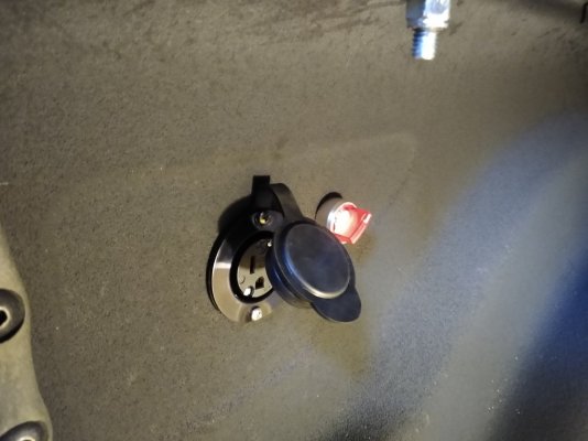

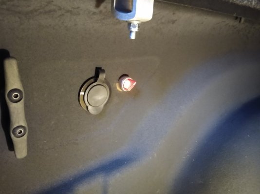

When my wife and I go camping we usually bring along a portable powered cooler that we keep in the back of the truck. I am tired of running the extension cord into the back of the truck. So I thought it would be nice to have a power inlet on the truck with an outlet inside the bed. That's what I did. I installed a 120 volt 15 amp inlet plug in the rear bumper to the left of the license plate. Then I installed a power outlet inside the pickup bed. While at it, I also ran an extension cord to the front of the truck to power the block heater so I don't have to have another extension cord running along the ground for that. I put a switch in the bed to turn on the block heater. Pictures...
