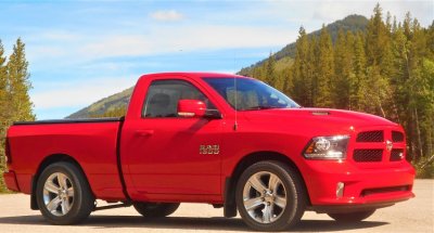

I'll throw one more idea at ya lad,lol.Have you considered lowering it,and running a shorter tire instead.That way you could stick with finding a 3.92 geared set of ZF diffs for it,and they'd be a direct bolt-in.Dropping to a shorter tire effectively deepens the gear ratio.If you put a set of 31" tall tires under it,the 3.92's would act more like 4.20's / a set of 30" tall tires would be like a set of 4.30 gears,and if you went down to a 29" tire,they'd act more like 4.40 gears,in comparision to a set of stock 33" tires.It's another option to consider.I run a 29" front tire on my converted and lowered 4X4 and a 30" rear tire,but my truck hasn't had the front diff/axles/driveshaft under it,since it hit the 10,000 mile mark,truck now has 50,000 miles on it,lol.If you want to keep it 4X4 you need matching sized tires all the way around though,i can get away with the staggered old school look / set-up,because i don't have all the 4X4 pieces under it.By law we need mudflaps up here,and i hate them,but i hate getting stopped worse,lol
