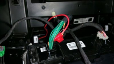

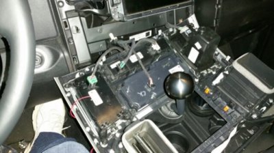

Mine. I tied into the dimmer light power from the console switches - orange /grey. Bought my led light strips from O'Reilly's $20 for two 10" strips. attached with 3M tape.
