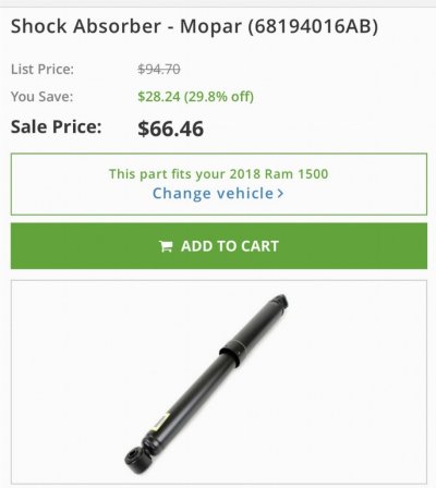

According to this, the shocks aren’t the same, so I dunno.
Top one’s for air suspension, bottom one’s for spring ride.

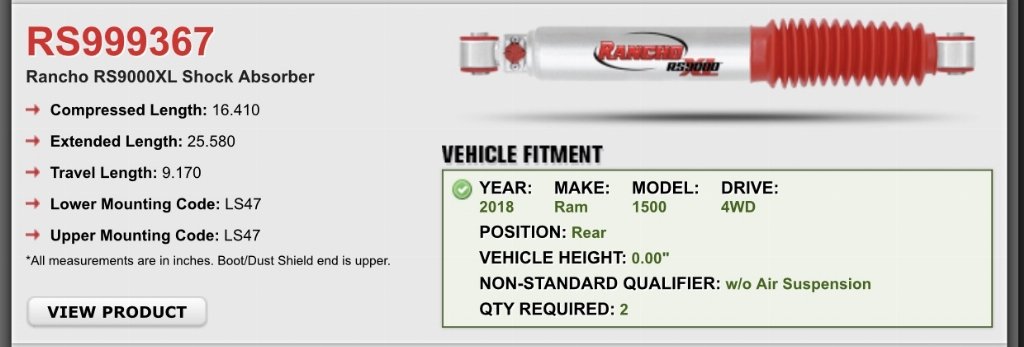

The mounts and travel look the same so maybe its just different valving. Maybe try some rancho rs9000 as they have adjustable valving from soft to stiff. I've know a couple guys who ran them years ago and the ride difference between settings was very noticeable.

Even Rancho’s say the same, w/o air suspension. Guess I’ll have to call them Monday and ask them.
