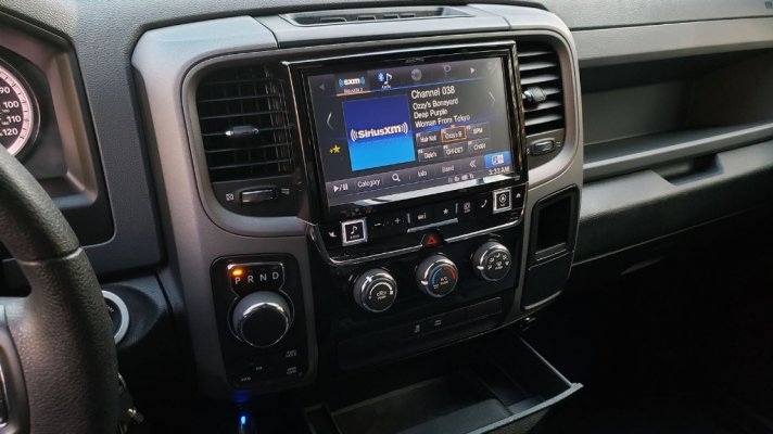

Plain jane Express 5.7 4x4 with a few things done already. Alpine X009 head unit, single JL 10w3v3, Kicker Coaxials in the doors and dash, tint, tonneau cover and Air Lift 1000 bags.

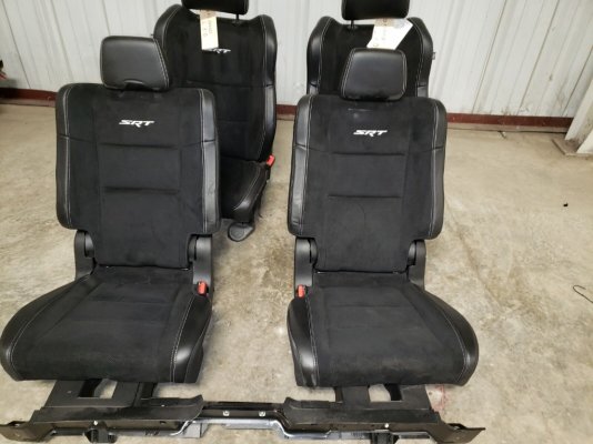

19 Durango SRT heated and ventilated front seats and heated rears.

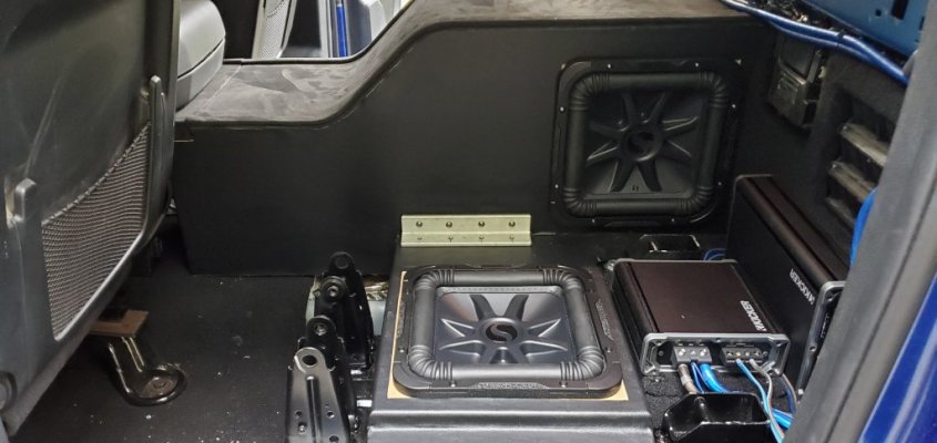

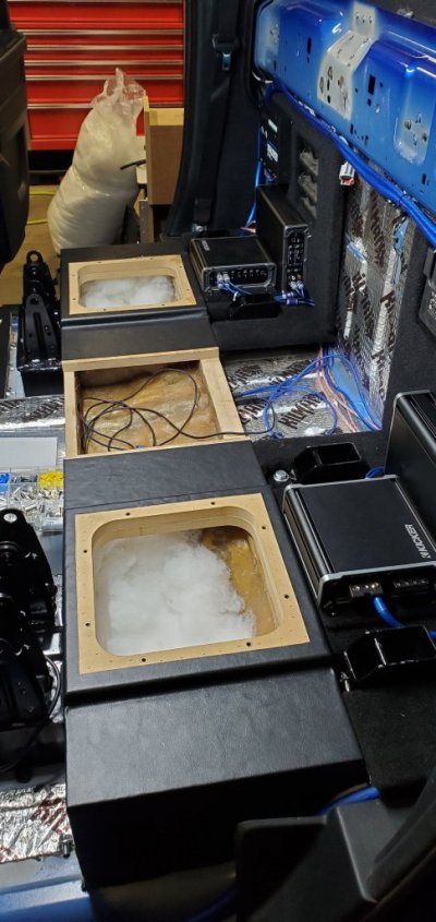

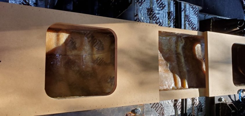

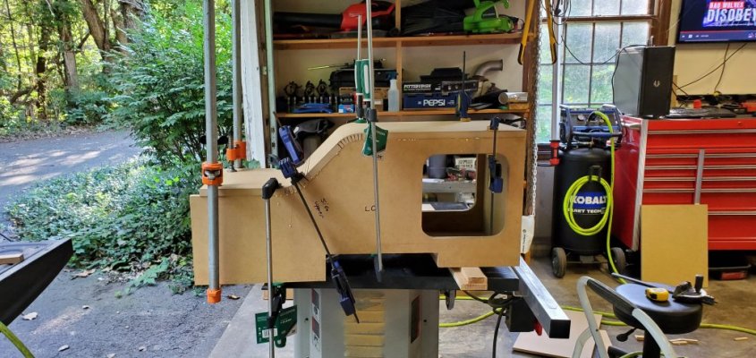

Ram front console and custom rear console/sealed enclosure/amp rack.
Quick draft of rear console/enclosure/amp rack.

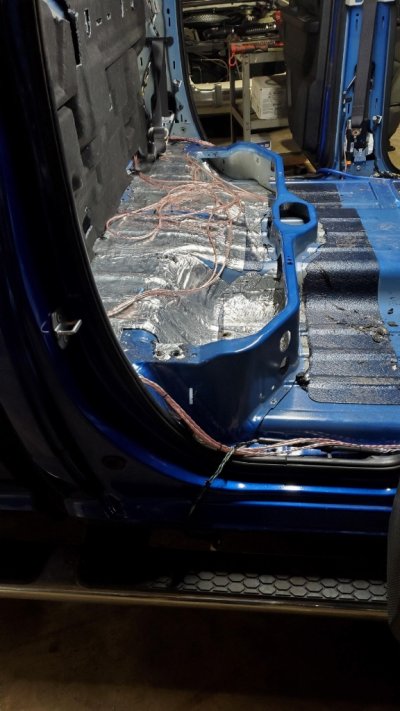

Swapping center stack bezel to console style and running speaker wire. Original head unit install used factory wiring.

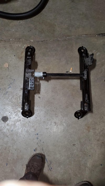

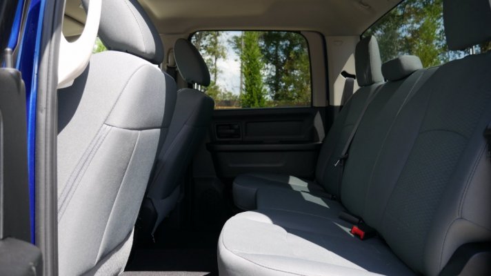

Removed tracks from SRT seats to cut off the Durango attachment points so I have a flat surface to work with.

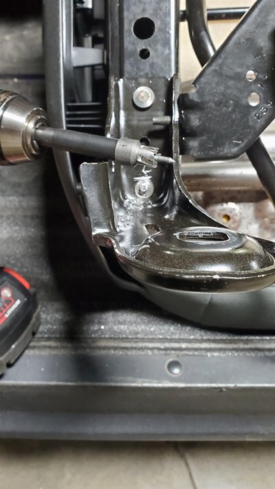

Using spot weld cutter to remove the rivets on Ram seats so I can use the attachment points on the SRT seats.
Out of time for now and it's my daily so in the front seats go.

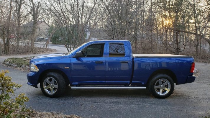

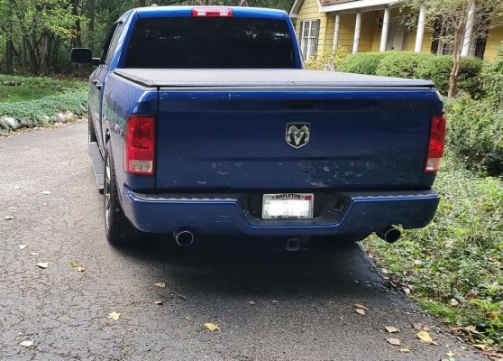

Nothing new as far as stereo or interior but I did make some changes. IHC 3/5 and Hellcat reps wrapped in 305/45R22 General Grabber UHPs.
Yes she needed a bath it had rained earlier that day.

Nice stance, how’s it ride?
Hate to say but as delivered not as expected, the supplied shocks are too short (19.5" max, 19"ish @ ride height) which makes it ride substandard IMO.
I just got different shocks that are a better match, if rebound ride quality is a fair amount better I will leave it but if not I will be switching to coil replacement bags for the rear.

I just got back from a test drive after installing proper length QA1s. Now it rides pretty close to original and I'm pleased.
When removing the supplied shocks I discovered they were more extended than I originally thought and they were fully extended at ride height.
Right side was even compressing the spring a touch and the bolt was cocking as I threaded it out of the shock/bracket.
The kit is sold as a 3/5 drop but to get the 5" you have to cut about 1.5 coils off the top of the spring.
I left them as is so in my case the shocks were extended slightly more than typical. Given the high angle of the shock the shock travels much less
than the axle so that extra inch would only change the shock position about 1/2".
