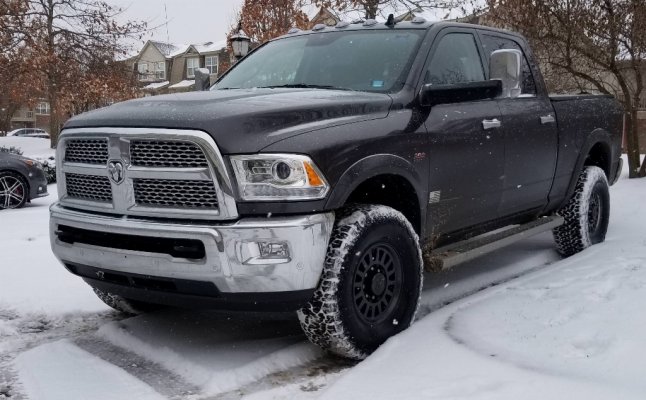

I got my new 17" rims installed yesterday. The rims clear the brakes with no issues, the tires also don't rub even at full lock. The tires do stick out about 2" though, I might end up getting some fender flares to keep stuff off the sides of the truck.
