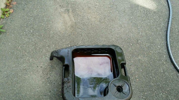

This is what didn't make it in the zip bag

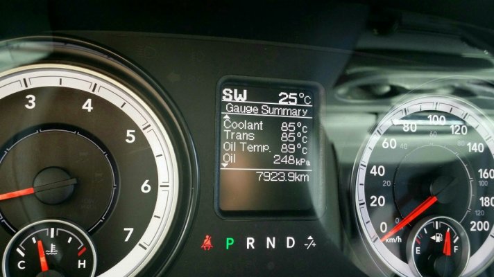

Here's the reading at idle

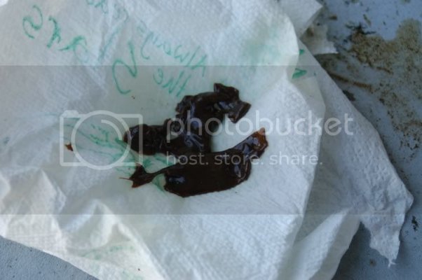

I don't know about the new Oat formula, hopefully by removing the bad actors we will avoid this, time will tell. Plenty of info on Oat/Air damage out there. If you run RMI25, any hint of anything wrong and it shows up in your overflow tank. Been running it in every vehicle for about a decade, stuff is amazing. Ran it in an old ford that had massive radiator damage, RMI25 turned it into slim and just pulled it from overflow. Pulled out a bunch of this over a week, and I assume the radiator was spotless. Ran into I sold it no problems.
RMI25 removed sludge from radiator- there was nothing in overflow til I ran RMI25, then my overflow looked like this.snot3.jpg
