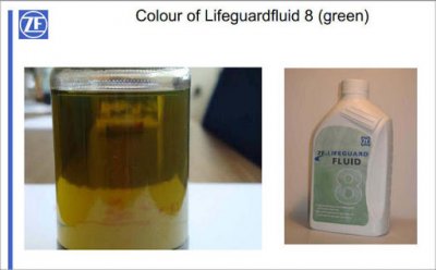

What color is the fluid in the 8HP? That looks like engine oil. They probably bungled the rear main seal replacement or it wasn’t even the source of the leak in the first place.

The Mopar 8 & 9 speed ATF (ZF Lifeguard 8) is a greenish yellow (technically green) color.
