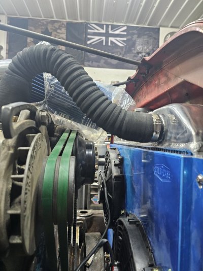

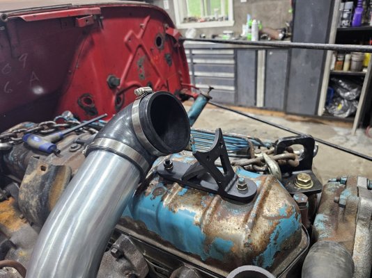

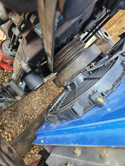

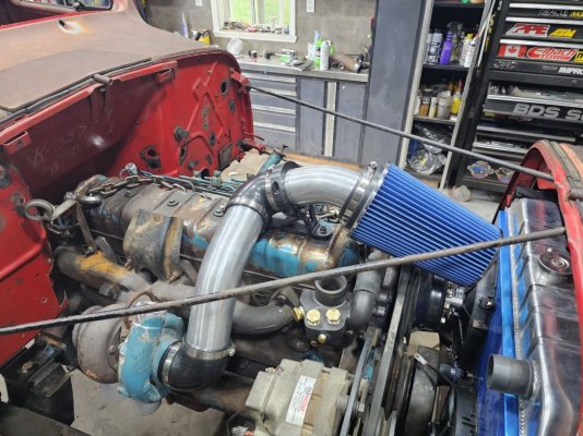

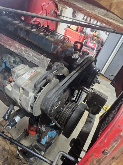

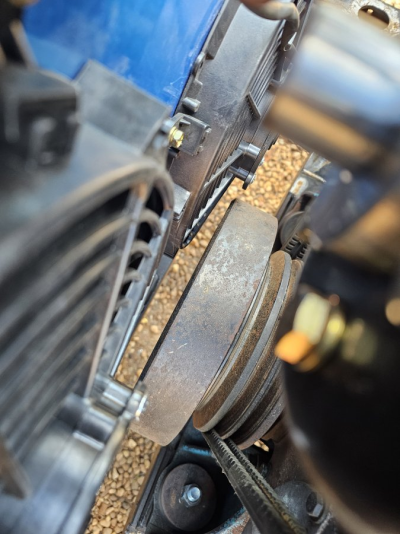

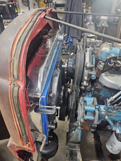

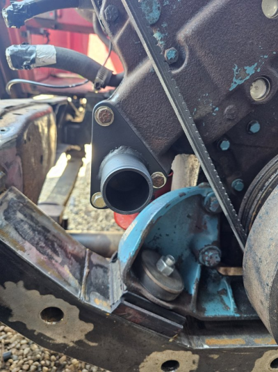

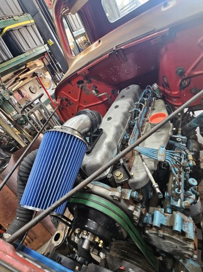

Tractor water pump gave me the clearance I needed. Save me over $1,000 in modifications. Alternator also clears the hood. So I don't need to waste money on the 7.3 alternator swap. So another $500 saved.

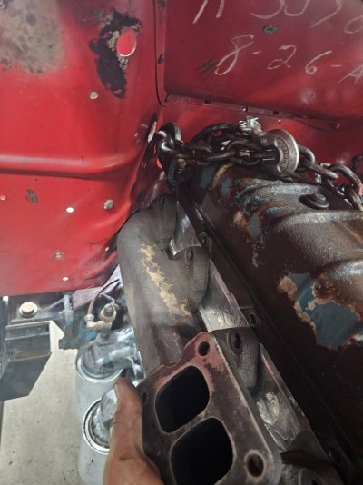

Unfortunately the exhaust manifold is hitting the cab :birgits_tiredcoffee
Time to get high, cut that ******** off and do some body work. Good thing I just got approved by VAC for 10g a day coverage :hat: the 7g a day wasn't cutting it anymore.

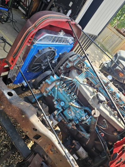

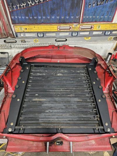

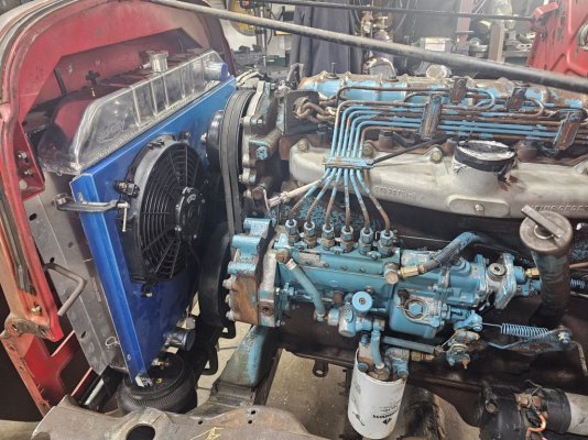

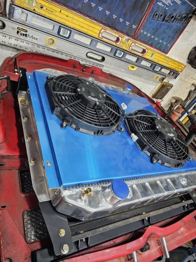

Unfortunately the radiator is going to hide the international emblem I made on top of the active shutters. We'll have to mount the radiator to the grill even though I didn't want to do that either. But with the tight clearances I don't have a choice.
But she does fit, I guess that's what's more importanter :anitoof:

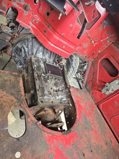

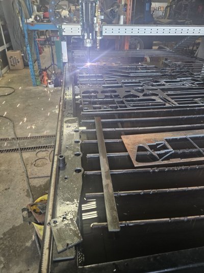

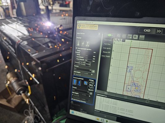

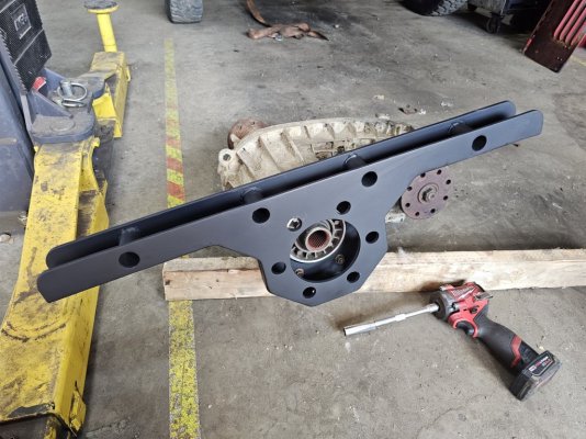

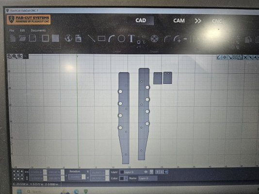

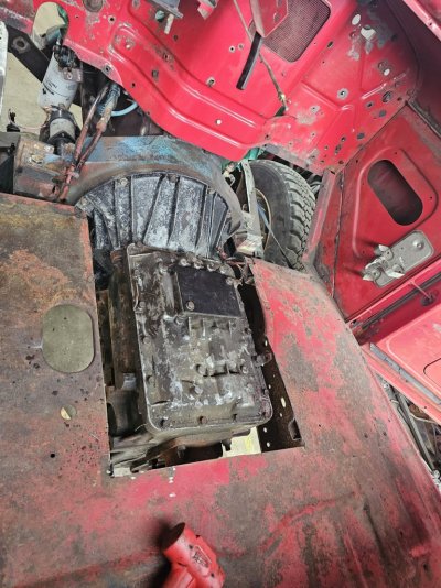

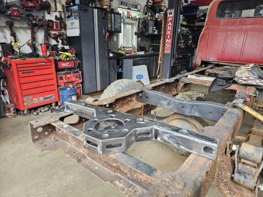

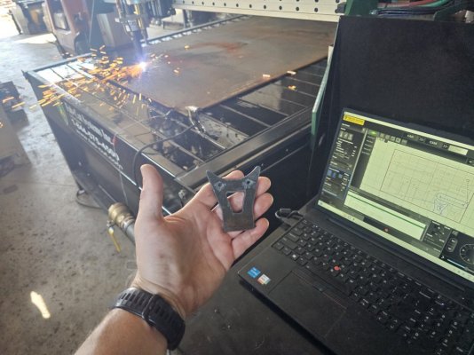

That Eaton 6 speed looked smaller on the floor... I need to cut some more. LoL.

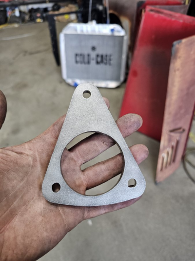

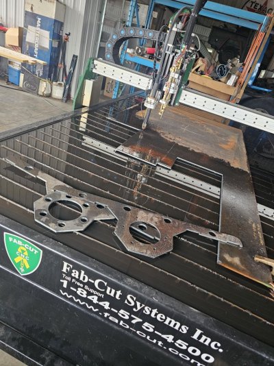

I radiator brackets will get cut tomorrow on the plasma table
Pretty productive day. but probably won't be able to move tomorrow :rolleyes:

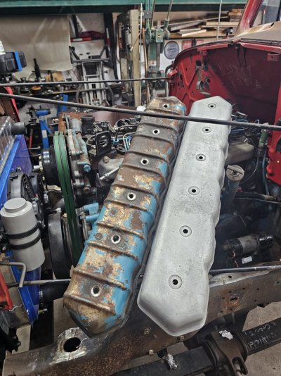

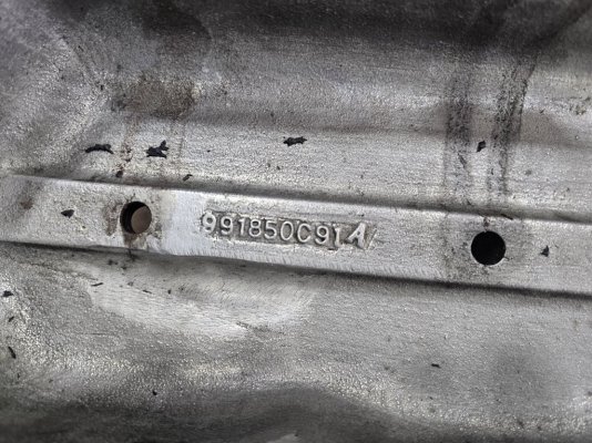

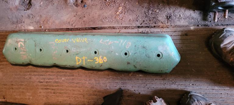

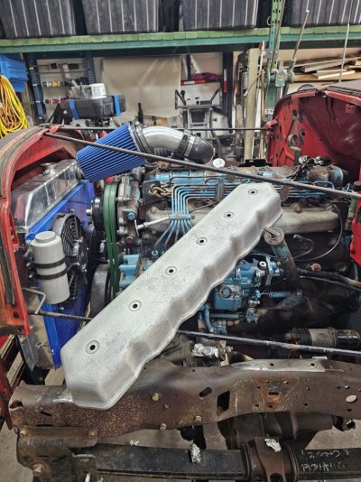

Holy ****, the holy grail of valve covers, #991850C91 :eek: International only made a few of them in 1994. These are all cast aluminium. :anitoof:
200$ CDN to boot...
Hopefully I get it tommorow, Will call first thing.

Did you adjust the valves while in there? Putting them about 2 thousants wider than spec seems to liven them up, at last on the 466 it does.
DILLIGAF
DILLIGAF
Canadian Forces
May 28, 2016
5,788
12,411
Canada
Im going thru the motor when I pull it to sandblast and paint the frame. :cool:
New CSD performance springs and CSD performance Hardened Pushrods, and new gaskets all around. :birgits_tiredcoffee
