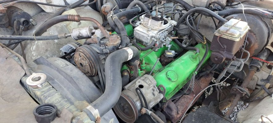

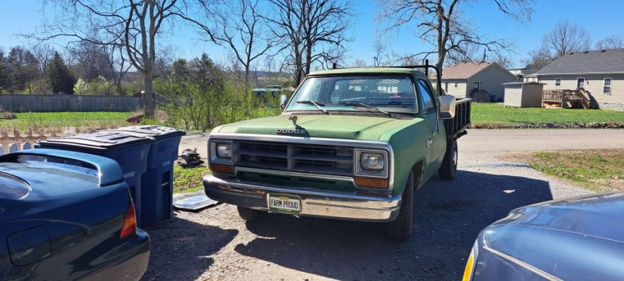

Hey, so brand new to the forum and Dodge in general, I just picked up this 1986 D-350 2wd with the stock 360 and 4 speed. I was hoping to get opinions on options for the engine. The current motor is not too happy and smokes like a steam train. So after some research I hope I am on the right track, Option A: Rebuild this motor (found a guy who says he can do it for $675) but this price doesn't include nor does he plan to do any machining, doesn't seem like that will work out too well long term but then again all new to this. Option B: Pull a LA 318 or 360 from a junkyard. Nearest pull-a-part has a big variety and if I only get the block and heads I could probably be out for under $300. Option C: MAGNUM!! For real though do you think a 5.2 or 5.9 swap would be worth it? If I reuse most of my LA stuff it probably be only a couple hundred bucks difference.
From what I have compiled so far is that either way unless I find another 360 LA I am going to be buying a flywheel. And to my understanding all 318s LA or Mag flywheels interchange as they are internally balanced motors. The 360 on the other hand is external so it needs a properly weighted flywheel and front damper to not shake itself to pieces. Also the 360 Mag and LA flywheels are weighted differently so they do not interchange.
So ideally I would like one of the Mag options as from what I have heard they seem pretty stout and you are better off finding one of those in a wrecking yard that is useable without needing to be rebuilt. I plan to go carb either way simply as I already have most of the stuff for it. Including the Holley 4 barrel that came with the truck. I also plan to to retain the LA front dress and timing cover since I already have it and it seems to be in working order.
Basically I am trying to buy as little as possible (at the yard) since they don't sell complete engines, rather they still charge per main piece (block, head, intake, etc). I understand that I will need a new carbed intake for which I plan to use this one. ($189 no-name dual bolt pattern for LA/Mag). I haven't decided on electric vs mechanical pump as its only difference is the hughes cam adapter or using a electric edelbrock pump I already have. I am not really worried about the cost of the intake since the dual pattern means I could basically keep it in the truck forever no matter what engine is in it. Not really sure yet about distributor, I may just reuse the current one in the truck as it seems to work well. So to my understanding that just leaves the flywheel, to which I am very confused. Specifically on the 5.9, is there an OEM one I could find out in the wild or is it just bite the bullet and buy it new, and if thats the case is the extra money worth it to have a 5.9 when I could potentially get a 5.2 and find a used flywheel? Also I have read about the weights on the LA 360 flywheel, if I remove them could I use it as is on a 5.2 mag since then I suppose it would be neutral balanced? This is kinda where I am at and really looking for some insight on the subject.
Like I said this is my first Dodge so still learning, not afraid of the work though and I am up for the challenge. My dad will be assisting me as needed so I am not too worried about the assembly side. Oh also the trans is in perfect working order with a brand new clutch kit so ideally not wanting to mess with that. Thanks

Happy to be here! Lots of interesting topics and discussions going on. You might be on to something here, I don't have any reason to rush the process and I want to do it right. We actually restored a 80s Yamaha together and it was a lot of fun and I wouldn't trade the bike for the world. Our biggest worry with the cheapo rebuild guy is that if there is something wrong with the block and it doesn't get taken care of properly we may be back in this place in a year or two and trying to find a LA 360 block. The motor is the truck's original with 143k miles. But it was also on a farm and it has a gooseneck so I imagine they weren't easy. I spoke with a machine shop and to clean it up properly will be about $500-600 as long as the block and heads prove good, plus the $675 for shade tree rebuilder ($1200+ and no warranty on assembly). I suppose we could attempt the rebuild ourselves (rebuild kit shade tree guy is using is about $375) but we have never attempted a full rebuild. Our draw to the Magnum engines is it would basically be bolt and go accounting for minor things like intake, flywheel, dist, etc. Then if it died in a year or two we would just throw another junkyard motor in it. Both are work for sure but I like the thought of being able to find good 5.9s for the next couple of years without much hassle. Still though, we haven't settled on anything yet and are eager to hear about the pros and cons for each option.

It would be mainly just a fun weekend kind of thing, but I would need it to actually do some work from time to time. I also want it to be able to comfortably drive 3+ hours at a time without me having to worry about it.(Craigslist/FB marketplace pickups) Probably not many miles anytime soon but I have no plans on getting rid of the truck, although I don't have a ton of money to spend on it I'd like to think I have enough to make it a very reliable and fun truck. (I'd like to stay under $2000 but its not a deal breaker to go over). You make a great point of freeing up the rings and the comp test, how do you go about freeing stuck rings? Would it be an engine out kind of job or is there some process or additive? Also the additional power of a carbed 5.9 is another draw, 250hp would be more than enough and if I don't have to throw a big cam in or anything to get it I'd be happy.
