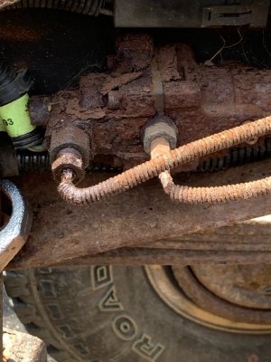

RWAL unit on 1992 Dodge. The brake line to the left feeds the unit and it's rusted through.
crazzywolfie
Apr 6, 2013
16,649
3,434
under the truck
81 93
5.2
only thing you might have to do if you bypass it is unplug the computer for the system which is behind the glove box. i have personally never found the system to do anything or at least nothing that would help stop better. only time i have noticed it trying to do something was when stopping on ice. i have locked up the tires on a wet road and never felt it do a thing. you can leave it hooked up if you want or disconnect it. all 89 or 90 and older trucks don't have any of that RWAL crap.
