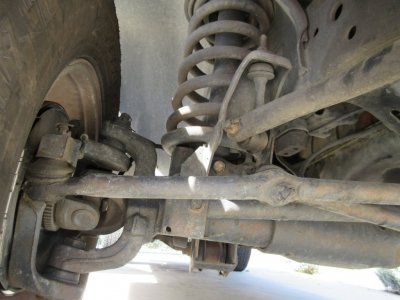

I do not have the 'Death Wobble' but I can feel some looseness transmitting up my steering column. I avoided looking down there until I heard a clicking noise that was in sync with my front wheel speed, so I looked. I found that the CV joint on the left axle was a goner. I did not want to do the labor so I had it replaced at the sum of $350. Believe me they earned their money (because I do not think they knew what they were doing, but I got my truck back and still (of course), have that feeling of a little knocking here and there through my steering column. I went to a shop and you would not believe how much they wanted to work on every thing but my ball joints. We are talking thousands of dollars.. So , I went someplace else and they wanted thousands of dollars ! Why? So, I got under the truck again and looked and found that I sure am glad I own tools. I went to O'Reilly's auto parts and purchased new upper and lower control bars with bushings installed, a new track bar, (L) and (R) tie rod ends, sway bar links,Pitman link and a new steering dampener..Friggen everything except ball joints for $499.00 ! I will take my sweet ass time and remove and replace it all. Why are shops like this? I am willing to pay somebody an honest wage for their work, but my gawd man, there is no sense of proportion. I am so glad I have tools......ApIMG_5690.JPG IMG_5691.JPG
