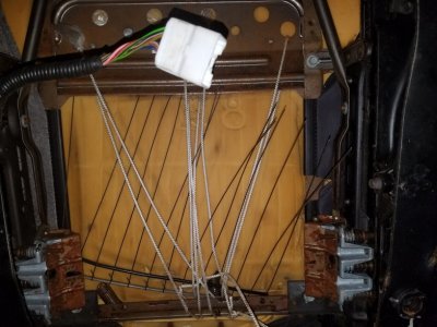

Spring assembly
It's not the seat bottom., it is the spring base. Pictures attached. Previous owner used rope as temp fix.

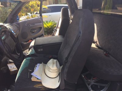

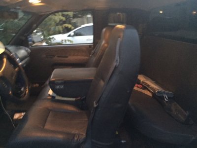

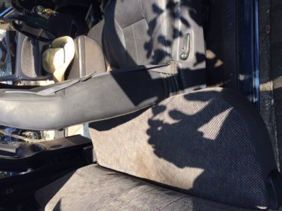

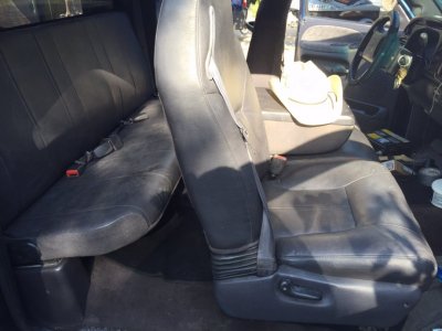

That is the actual seat bottom, its 4 10mm bolts that hold them in place, can swap between pass and driver.

Great so I can swap pass driver, awsome. Where are the 10mm I have to remove to get seat bottom out?

In that first picture you posted you can see 3 of the four, they are in the four corners under the seat. then you simply lift up, some come out easier than others.
