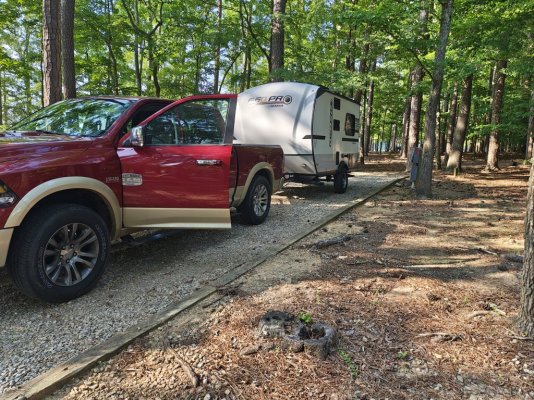

I have a 2013 1500 4x4 5.4 hemi, w tow/haul and aftermarket trailer brake. About 154k miles. Camper and extra weight, about 4000lbs total
I towed my camper for the 1st time last week. Did some mountains going the southern route around Asheville NC including Black Mountain.
I forgot the tow/haul thing, but did have it off overdrive and down shifted as necessary. (Used to have a stuck shift)
On the way my thermostat died. I got that fixed, learned how to find the screen that shows exact temps and went on my way.
On the way home to AL, I had the tow/haul on, it seemed like it struggled going up some of the mountains. Felt like I had to floor it to go 50-55mph. Hottest the temp got was 1 time 244. Most of the time 230-240. It was 90-95 outside.
Am I supposed to push t/h and let it do its thing or still down shift?
Is this normal to feel like it was struggling? I'm well below the weight limit, and bought a V8 hemi just for this year of camping.
I want to go out to Colorado but am a little hesitant.
