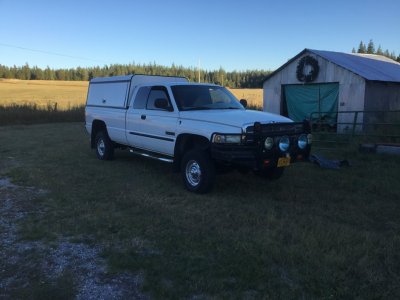

I like the KORE leveling kit, but unless you have a CTD, it is going to give you at least 3”+ of lift up front. It comes with sway bar blocks and the Bilstein 5100s. As it is mine still seems to be pushing a 3” lift with the CTD and a Ranch Hand deluxe front bumper. But the ride definitely feels better than with a puck/spacer.
Still looking at options to lift the rear end about 2-“
As it sits now:E6C25299-5672-464A-892C-C5F8A394A9A8.jpeg
