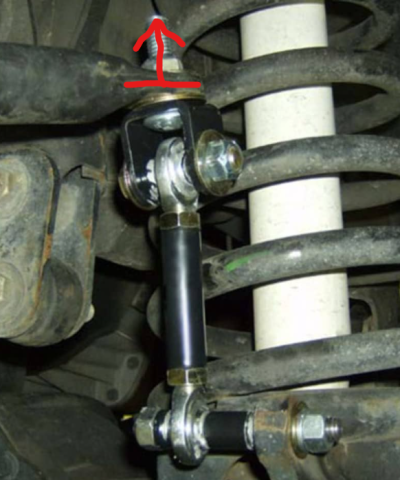

What do you mean by the end links being adjusted?
As in, when you put on the level, it pushes your steering knuckle/control arms/wheel/etc further down away from the frame, taking the bottom end of the sway bar link with it. Meanwhile the sway bar is still attached up high to the frame. If you don't make some sort of adjustment to shift the sway bar up on the link, thus "lengthening" that connection, you will end up binding the link. The link shown in my pic has a hinge in the middle so that won't happen, but you can see what I mean with needing to shift the sway bar up higher on the link.
I'm not super familiar with the OEM set up on the 1500s, but on my 2500 the end link is a solid piece with no hinge in the middle to prevent the binding, so when I put a level on mine (1.5-2" lift on the front) but I forgot to adjust my end link connections, I ended up bending my end links pretty bad. That same binding that bent the end links could be putting a bind on your bushing as well, causing them to fail.
Even if your end links do have a ball joint in the middle to give some articulation, that will only go so far. Since your factory length links keep failing, either try shimming up the connection to lengthen them artificially, or buy extended links that are made for lifted vehicles.
Also, the hard poly bushings aren't as soft and will sometimes make noise, but worse case scenario you could use those and they should last longer than the soft OEM rubber ones.
