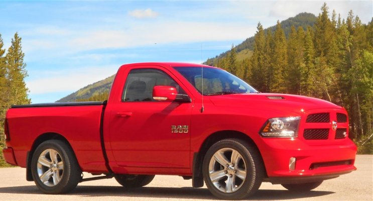

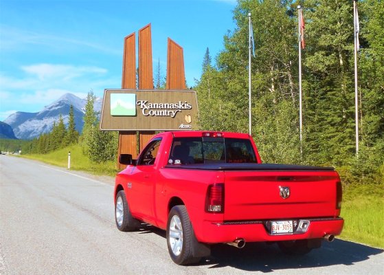

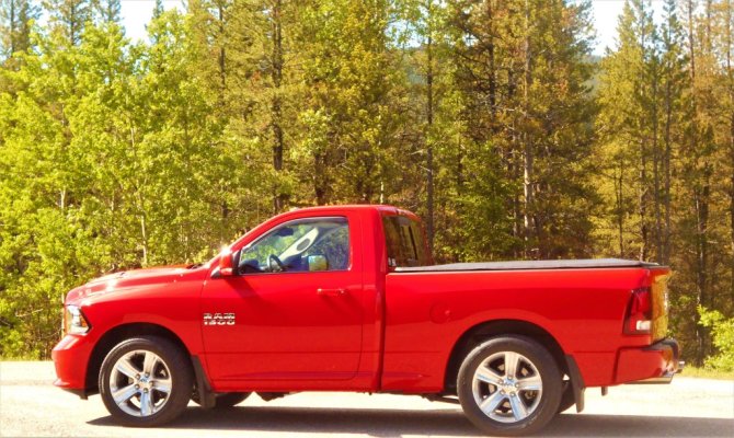

I run a 295 / 45 / 20 which is about 30.5" on the front and a 305 / 50 /20 on the rear which is roughly a 32" tall tire on my 2 /4 dropped 4X4 . No front diff or CV's is why i can get away with a staggered size on a 4X4.
