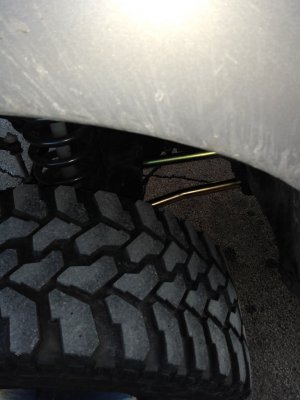

So is the control arm the part on your pic just in front of the coil spring ? And thanks for getting back to me . Made my mind up .

Ok , I went on You tube and seen what they are . I put new ones on the rear of my El Camino last year . Duh ! Did you install them and are yours adjustable ? How do you determine what length pu put them ? Thanks Again for the help

No they're not adjustable 1/2 over stock, I guess leveled up to 3 inches 1/2 inch over is all you need. Thuren,carli and metal cloak all make fixed control arms and say the same thing. The guys at CJC offroad are also very helpful when you email them.
