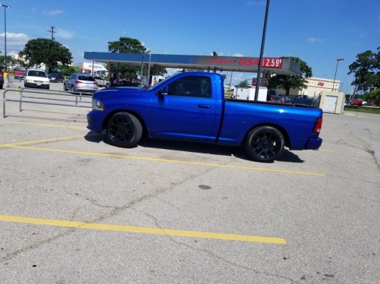

I have the R/T 22x9 factory size rims. Previous owner got rid of the stock ones sadly. Mine also has a 2/4 drop. 20180516_161546.jpg20190126_154425.jpg

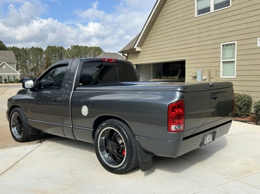

Here's 22s on my RT, with a 4/6. It's not a daily

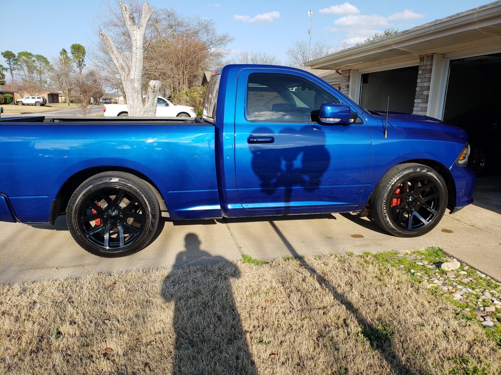

20's with 305/50's and 295/50's on a 2/4 drop.I'm old school i actually prefer some wheel gap :waytogo:

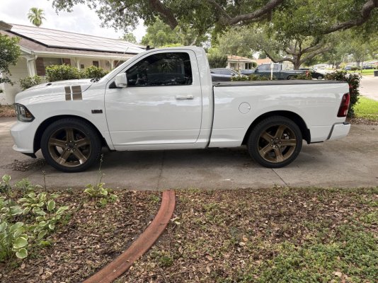

stock powder coated 22's 2x3 drop
