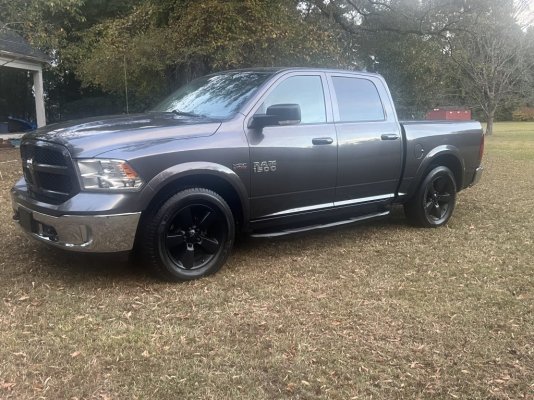

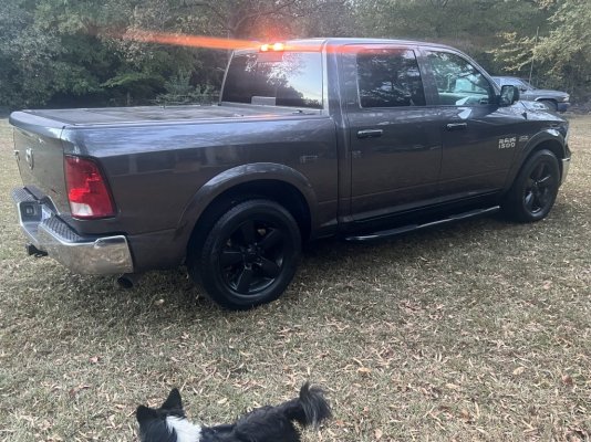

Hi guys,
I bought my best friends super clean 2015 dodge ram, 1500 Hemi crew cab, 2 Wheel drive.
Love this truck more than I can tell you but I’m not enjoying the body lean in curves at all. It has 1905,000 highway miles on it and has the factory 275 6020 tires on it. My question is would it be OK to add some two 245-50’s or 55-20’s on it to get it down closer to the ground so it handles better along with a rear sway bar of course?
I don’t have money to experiment so thought I’d come here and ask the experts. Thanks for any help you can provide and merry Christmas!

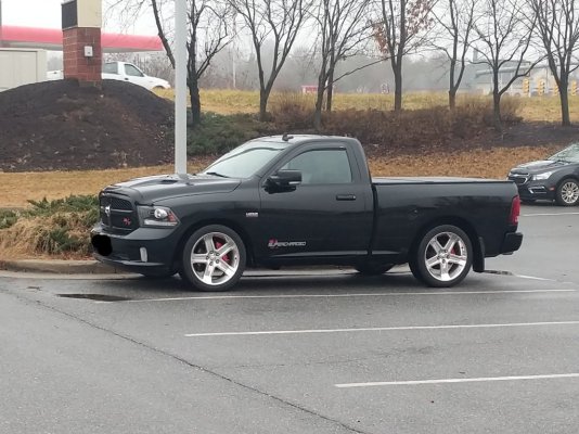

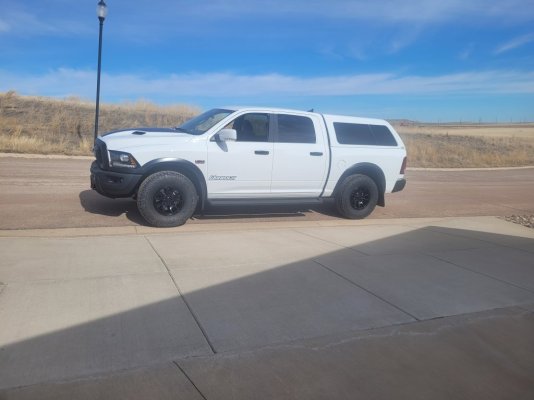

Nice looking truck. If you want handling keep checking in a few of us old guys, have some history with rams. Here's mine, two different ends of the spectrum
Black supercharged 14 RT RCSB, 2 wheel drive
White 2024 1500 classic warlock, 35s and not lifted
