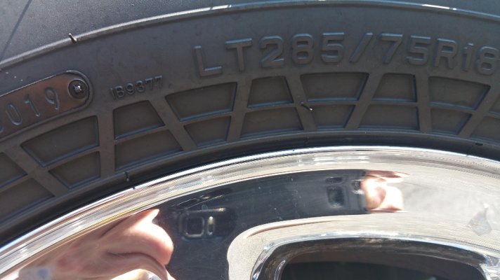

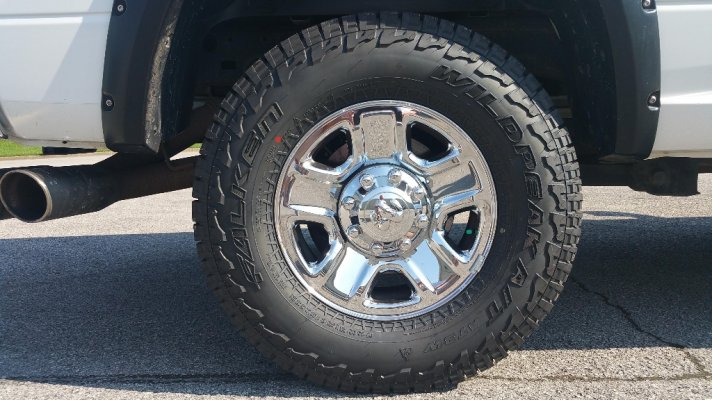

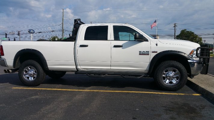

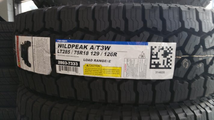

I just put Falken Wildpeak AT3W's on my 2500. Stock 18" rims originally had 275/70R18 tires. I bought 285/75R18 to give me a 10mm wider tread and a taller sidewall. They measure 34.8" tall. I like more sidewall. It just "looks correct" on a truck IMHO. Lots of extra space to fill in those 2500 wheel openings. Then again, I'm old so, that's all we had back when. I had 36" tires on 15" rims on my '76 K5 Blazer. 12.5" sidewalls looked fantastic! Yes, it bounced.
9730817e9f878187618b53b626b39610.jpge52fbe62b1957263cdacbad45bde649f.jpgf9d0d61e7f919d02404ac7432c036783.jpgef92a386771874819f0f7adbee93cbec.jpg
