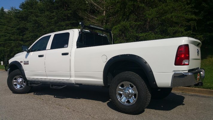

I just couldn't NOT compare Big White to Little Black.
Big White not a road racer at all! Although, I have drifted her on a few off ramps. Very slow loss of traction, easy to do)
Little black...hmmmmmm... COULD do road race. Something that short looks like it would be quick to react. A lot quicker than that cruise ship I drive, LOL!
And I am NOT making fun of Little Black...I had one too. A lot littler.....I traded it in when I bought Big White. hahaha.a986ea17ab33b224f722f3ceaeb69116.jpge8fb3f4ce4514bd1e98ec2e030452c5d.jpg

Ok...... I thought this thread was asking about 17 or 20" wheels on a members 1500 .Ya lost me how did we get to 1500 vs 2500 and a car ?

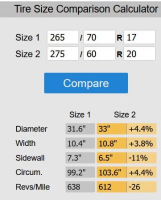

Mostly FALSE -- I have a 2015 4X4 Laramie CC that came stock with the 20" wheels and 275/60R20 tires and immediately changed them for the Rebel 17" wheels and Toyo 285/70R16 tires.
The stock 20" rims and tires are ACTUALLY very slightly (0.3") larger in height than the 17" rims and tires. This means the 17" rims and tires are SLIGHTLY smaller in circumference (distance around the tire) than the 20" set; having a smaller circumference means the 17" set goes slower (69.4 MPH) when the 20" set is going 70 MPH. (If my speedometer is showing 70, I am actually doing 69.4 (I can't tell the difference; can you?))
Something that isn't mentioned but should be - you will get better gas/fuel mileage with the 17" wheels because you are turning (and moving) less mass/weight. My instantaneous (calculated at that exact moment, NOT average) fuel mileage at 80 (YES, it is the legal speed limit in some places) is 22 MPG (Yes, I have an EcoDiesel!)
The tires (at least, my Toyos) are slightly wider than the stock Goodyears and so I do get a more "springy"/cushioned ride due to the approximately 1.5" higher/larger sidewall, but the extra width (0.4") seems to make up for the some of the loss of stiffness.
Oh, and yes, the tires are less expensive if they fit 17" rims -- same tire/different rim - larger tire costs more.
The Toyos DO make a bit more noise than the Goodyears, but the difference in tread pattern and design is worth the VERY slight increase in noise of a off road design over a pavement design.
Check out this site to compare the difference in rim/tire size:
https://tiresize.com/comparison/
I don't know if you will have to insert you sizes, but that is where my information comes from.

Mostly FALSE - The stock 20" rims and tires are ACTUALLY very slightly (0.3") larger in height than the 17" rims and tires.
You type false sir. I said the 20's have a higher diameter, which is another way of saying larger over all height. Please retract your errant allegation of the information you yourself confirmed ;-) .
While your making corrections, according to the on line calculators the the difference with stock wranglers is over 4%. This is in line with my tape measure as I have two sets of mounted 17's and a set of mounted 20's, and my observation of the limited time between swapping tires and updating the tire size with Alpha ODB of the speedo being 4KM/h or 5KM/h out at 100KM/h.

Something that isn't mentioned but should be - you will get better gas/fuel mileage with the 17" wheels because you are turning (and moving) less mass/weight..
I don't. Don't know why.
Best guess: The stock 17's rotate 26 more times (4% more times) every mile. That may off set the 40lbs decrease in weight of the stock 17's over stock 20's (40lbs on a 4,800+lbs truck is 0.08%).
