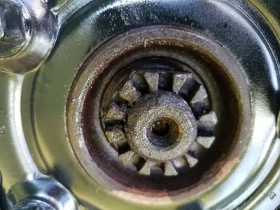

jacked it up, and wife shook the tire, was moving around on the wheel bearing.

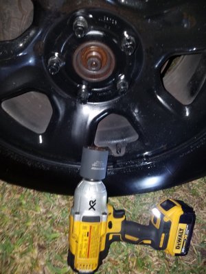

pulled the center cap off, the center of the wheel bearing around the spindle nut was RUSTY, like it has been grinding for a while.
so I ordered a Wheel bearing, they were from $40 up to $300 for an OEM, i got a "recognizable brand" for $50

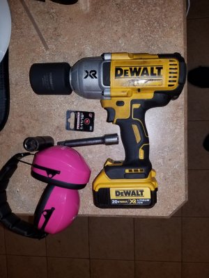

is 1 11/16 the right size socket for the Spindle nut?

1 1/16 is the correct size of the nut. I hope you have an impact wrench to blast that rusty nut off with. When I did mine I broke 2 half inch drive ratchet wrenches, a 1/2 inch drive torque wrench and a 1/2 inch drive breaker bar. It never budged. Came right off with the impact.

Amazon showed the socket with the wheel bearing.
