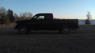

BeauDuke01 gave me some good advice about lowering a 01 and this is how i lowered my 01 for $39.95
First front spring hangers remove and flip over and reinstall couple hole may be off a bit drill them out install grade8 bolts and loctite
Second get a set of lowering shackles from Auto Zone $39.95 in stock i know and install
Third front coils need to be cut exactly 1 coil and they dont bottom out promise
That easy got all my info from this site,and how i lowered my 01 for $40 thats it

Looks clean man. Very nice
