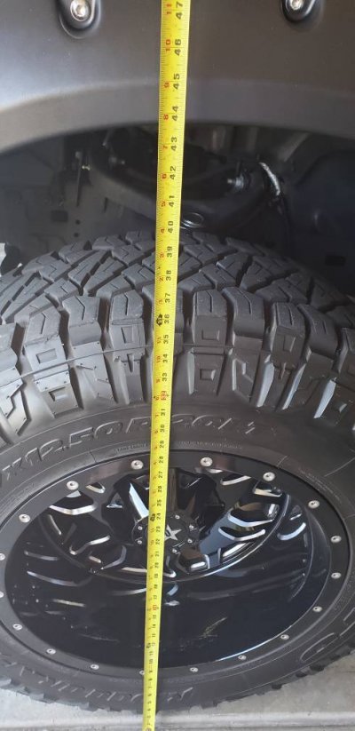

I'm also wondering what your measurements are from the wheel center hud up to the fender line for front vs rear.

Set up now is Maxtrac 4.5/3.5. I did look into CST prior to pulling the trigger, but obviously went Maxtrac.
35x12.5 on Fuel 20x10's
