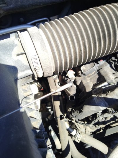

Cold engine. Wipe. Stick in, pull out. The oil level is right around where the cord meets the aluminum which makes sense since there's 6L in there and the truck is parked on a forward angle. I believe I'm around 5500kms on this OCI. PUP 5w30.

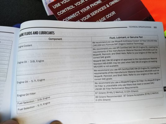

For the 2021 classic model year the owners manual is as follows:
An extra 400ml of oil harms nothing. 6L in and keep the old bottles. When you drain it at the next oil change you should get somewhere around 6L out. Put it in the old bottles to easily check. My engine burns f-all and I always get relatively the same amount out as went in. I might check the dipstick twice during an OCI which is 8000kms or 3-5months. If you're going to be **** (****** derivative slang) about oil, try it this way.
