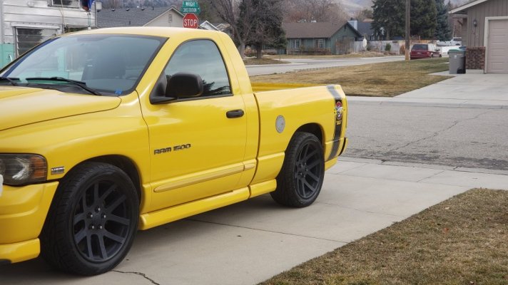

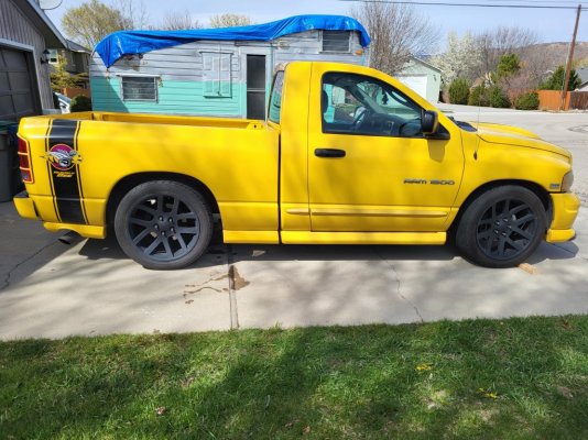

Rear height with bell-tech 2"/5" front-rear lowering kit, and General Spring KS heavy duty leaf springs. --Using bell-tech's drop shackle on the rear leaf spring perch--
Re-install factory rear leaf spring shackle-- back to level :cool:
