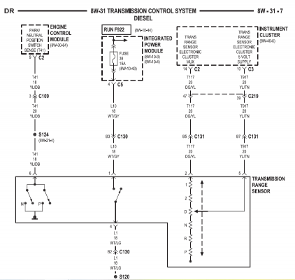

Check out your transmission range sensor. Seems to affect shifts. Maybe it's sending a faulty signal to the computer which it finally ignores.

Is there another term for transmission range sensor? I can't find it on the diagrams online. I did however notice on one of the diagrams that I was looking at, there is a governor pressure sensor. I never knew about this. It sounds promising. The only 2 sensors I have not replaced that I know of is the trans speed sensor and the governor sensor. I do not have a scanner that reads transmission codes.

Oh hell, I was reading my 05 service manual. I just assumed your 02 would be the same. There are a bunch of references to it in the 05 manual.
