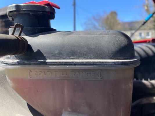

Before we take it out for a drive, I want to fill the coolant overflow jug to the full line, I know the coolant is orange and it’s impossible for anyone to know for sure what’s in there but would this year be HOAT coolant? My 2016 Ram is OAT coolant and if my memory is correct I’ve read that if the HOAT and OAT are mixed they will congeal?

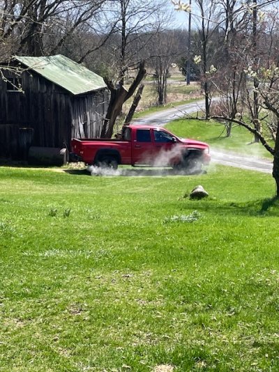

IMG_4013.jpegIMG_4014.jpegIMG_4016.jpegI put a battery in it today, filled the coolant overflow up just a hair above the full cold line, started it up, it smoked out a lot of white smoke, I took it for a 5 or 6 minute drive and let it idle another 10 minutes or so. Checked the coolant overflow after it had cooled and the level had went down roughly 1/8” Took it for another 5 or 6 minute drive and now I’m just waiting for it to cool again so I can look at the height of the coolant in the overflow. I also noticed what looked like a little bit of bubbling in the overflow tank while it was idling? Not sure if that’s supposed to happen? I do believe I can smell the coolant as it’s running. It doesn’t overheat though when driving and the white snails does go away and no white smoke even when I first started it for the second little drive
