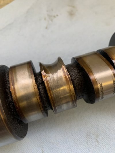

Had lifter cam failure in a 2011 5.7 2500.

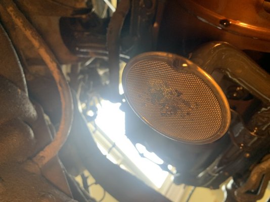

I found so much metal sludge and shavings in pan. I figured I’d need a full rebuild on it
How much metal is in the VVT solenoid? If the screen on it is full of shavings,then you'd want to do a rebuild.

Bought truck off my brother
Think it was a fleet truck before he had it.
He did not maintain it at all lol
Hard to tell by your pic,but it does look like there might be some piston chunks in the pan

Oof yea that pan looks prty bad you should pop a rod cap see how the bearings look does look you have chunks of something in pan?.
