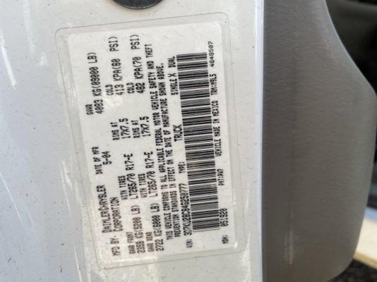

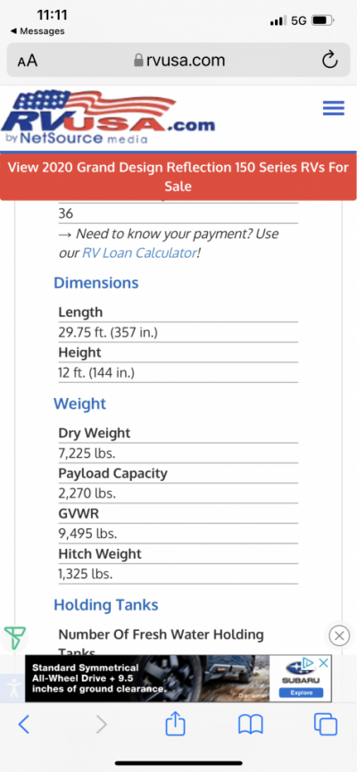

Hello, I have a 2004 2500 5.9 that we use to tow About 7k pounds of hay with a gooseneck and no problems. Baby girl pulls like a dream uphill and downhill and with trailer assisted brakes and safe driving speeds we do well. We are looking at buying a new to us 5th wheel with below specs. The other is our truck specs. I don’t see a problem towing with our tuck, however I am thinking of adding rear air bags. Any thoughts or suggestions would be greatly appreciated. Just want to make sure I’m not missing anything.

You should be okay with this. If you post this up in the 3rd Gen section you probably get a better response about your truck for air bags and the like.
