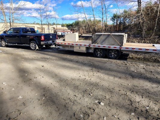

This has been an interesting thread, I have changed tow vehicles this summer. I've gone from a 1500 Laramie with the full air suspension to a 2500 Laramie with the rear air suspension.
Neither one has given me any handling issues, my heaviest load with the 1500 was 4 tons of coal on a heavy 14K deck over trailer. Now that truck did spin out on the driveway and I had to call for assistance. My brother came over got the tractor and snaked me right on up.
This 2500 has had about 12,600 pounds of concrete block on my 14K aluminum deckover absolutely no issues on the road, dropped her into low range first gear and walked up the driveway with no issue, I did have my brother over and going up in front of me just in case on the first load (driveway is dirt/gravel and a 14-16 degree slope, 20-23%).

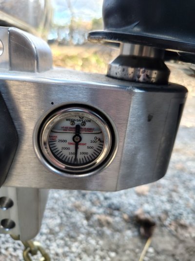

Only 3 and half blocks, I do like the weigh safe indicating hitch

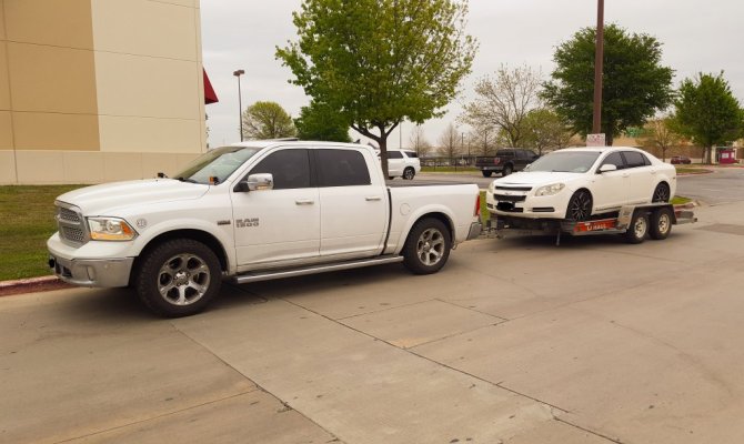

when i tow, the heaviest weight is over the axles.
That blanket statement can get you in trouble, because it's the tongue weight that will make or break you.

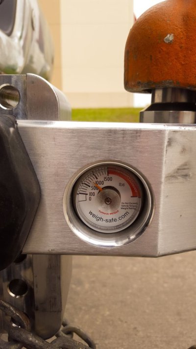

2007 Malibu curb weight ~3,297 lbs, so this one was a tad heavier.
U-Haul trailer ~2,000 lbs
= ~5,297 lbs total weight.
Tongue weight ~760 lbs, which comes back to ~ 14% of the total weight.
This thing drove live a dream, didn't even flinch pulling that weight to be honest.
IF the main weight would have been over the axles (i.e. car loaded backwards, which U-Haul doesn't allow), the tongue weight would have been too light, and potentially deadly sway could have occurred.
I highly recommend Weigh Safe hitches. No more guessing, worth the money, and made in the U.S.!!!
