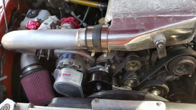

I'm using a vortech v7-Ysi originally driven by the rib belt. I felt it was slipping from what I could see from datalogging. Built a 2" cog belt drive system. Takes bit of work to get it aligned. But once it is adjusted it is good to go.. This is a daily driven street truck and I'm still on the original belt. The truck has perfect street manners. I highly recommend using a cog drive.
