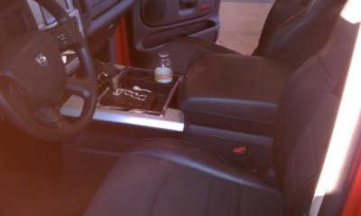

That’s why I keep pics, I literally can’t find any info on the internet about a console swap into a 02-05 truck. If there are pictures, photobucket ate them :(
If you need anymore pictures let me know, I’ll be happy to help. I still have a plastic trim piece on the passenger side to make up to cover a hole there
Ok long explanation, but maybe someone can help with my problem. I don’t have the factory shifter hooked up yet. I am planning on a 46rh swap with a manual valvebody. Since I have a 4x4 truck, I have to make a hybrid trans. I am using an RH case with a 4x4 RE overdrive housing because of the trans length. That’s the only way it will bolt up. The way the trans works I can’t have a automatic D that will shift gears without a super expensive standalone controller. So swapping to a manual valvebody is about the only answer. Now my problem is the console shifter has an electric manual shift. So I’ve been considering wiring a servo controller and a 12v servo to handle the shift cable. Not sure it’s possible yet. Other then that, I’ll have to remove the shifter and put an aftermarket shifter in.

I've only seen one before today, and it was just a pic with no help or explanation. Biggest things I've wrestled with is how to route the shift cable through the dash and mounting the console itself. On the 4th gens it's to the dash up front and somewhere in the back or middle to the floor. Also figuring out my OD button with the floor shifter. I'm waiting until I put in my 4th gen seats. This is the pic that inspired me to try:

I’m pretty sure I’ve come across that same picture. I made my own “custom” brackets but it’s completely hillbilly rigged up. Nothing fancy. I need to start a thread about it, I’ll be back to the final touch ups in the next few weeks
