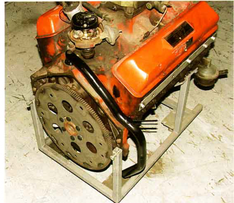

Back before any kind of smog emissions were mandated ...............
Vehicle engines had what was called, a road draft tube.
That tube, was there to relieve the pressure that built up in the engines Combustion Chamber.
It was a simple devise, it was a metal tube, that fit into a hole in either the rear or side of the block, it was long enough to hang below all of the sheet metal of the vehicle
look at the Black tube by the fly wheel
then the government, mandated that the road draft tube be removed & a fitting must be inserted into the block & a hose must carry the pressure to either the oil fill cap or intake manifold
then rules were again changed & the PCV was designed, that was after some bad designs, that made a California's Governors Brother In Law very rich.
Today the exhaust passes through the PVC & the pressure is run through the engine again, instead of just running it into the exhaust & then into the Catalytic Converter(s)
