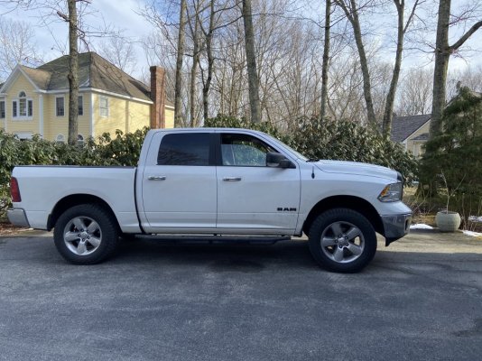

Have the 5100 installed, put on the 2.1 and Now i’m .25” high in the front
