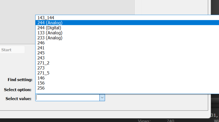

So, I went back into my old BCM config backup .txt file to see what it shows for transfer case type, as it has been a long time since I messed with it. Here is what is set:
So, it would appear that the same logic is used for all those transfer case types. So, just out of curiosity I looked to see which options are listed under 2006-2012 non-Powernet and it shows:
So, it would appear that 244 Analog would be your best option to try. On my 2013 BCM backup file, it shows my current programming to be compatible with the Analog 244, the 44-45, the 44-46 and the 44-48. The Analog 244 is the only one that shows up for the non-Powernet trucks.

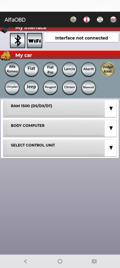

First, connect to the Body Computer:

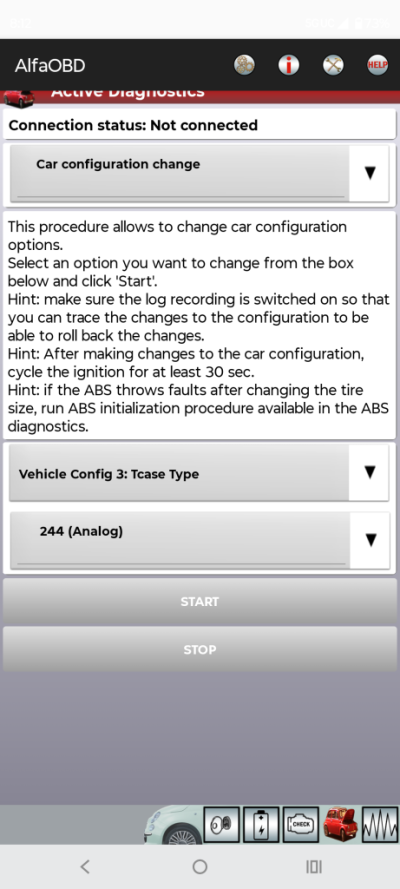

Then 2nd, click the little icon on the bottom right, that looks like a car with the hood up (active diagnostics).
Then third, in the top drop-down, "car configuration change"
And the other 2 drop-down, as shown here
Are you saying that none of this is there?

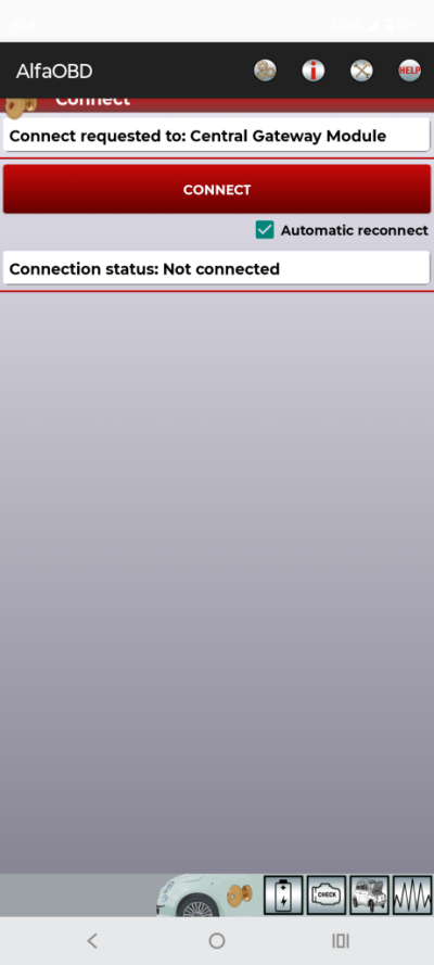

Make sure that you click the button that says "connect".
And that the status bar says"connected".
