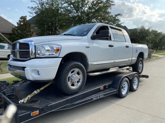

Long stort short my 2007 Dodge Ram megacab 4x4 5.7 hemi dropped a valve guide at 235,000 miles. A guy is selling a 2007 Dodge Ram 1500 2wd hemi 5.7 motor with 90k orig miles for $1500. The Dodge dealer told me I had to use a 5.7 from a 2500 or 3500 only as my megacab is on a 2500 frame. Is there any differences in the hemi motors or a reason one wouldnt work? In my mind they should be the same motor no?
