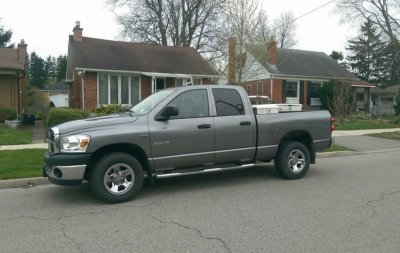

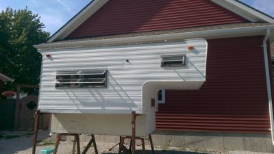

I recently got a great deal on an older (1975-78) 8 foot camper and have payload concerns.
When I hauled the camper home I didn't notice any unusual swaying or groaning from the rear, and the leafs, while not completely compressed, were nearly at load I believe.
I don't know the weight of the camper, but the guy I purchased it from had it on a stock 98 F150.
Surely my Ram can handle this thing?
I have 1500lb helper coil springs I want to install as well..
I attached a photo of the camper and my truck. Unfortunately I have none with it loaded.
Thoughts?

The truck without the extra helpers in the back should have no issue with the camper being on the back.

The payload on that truck should be about 1400lbs. There should be some sort of info on the camper that says it's weight. Check the door frame. If not you could load it up and head to a truck scale.
