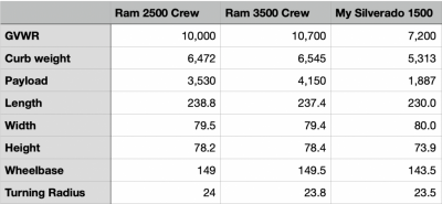

I was curious on how these HD Ram trucks compared to my 1500 and created a quick comparison spreadsheet. Surprisingly they are not that much bigger, I was not expecting the turning radius to be the same. (see attached image)
RAM 2500 Crew:
GVWR
10,000
Curb weight
6,472
Payload
3,530
Length
238.8
Width
79.5
Height
78.2
Wheelbase
149
Turning Radius
24
RAM 3500 Crew:
GVWR
10,700
Curb weight
6,545
Payload
4,150
Length
237.4
Width
79.4
Height
78.4
Wheelbase
149.5
Turning Radius
23.8
1500 Silverado Double cab:
GVWR
7,200
Curb weight
5,313
Payload
1,887
Length
230.0
Width
80.0
Height
73.9
Wheelbase
143.5
Turning Radius
23.5

If you go 2500 diesel be careful on camper size. They are pretty restricted by payload as well. Typical payload is about 2100lbs. Shoukd be ok with the camper you mention but if you are going to go with a bigger camper then a diesel may require a 3500. A 2500 Hemi has about 3000lbs of payload

@dhay13 Agreed. Totally 100% ruled out Cummins on the 2500 - it only adds 300lbs over what I currently have. In fact, have ruled out the 2500 entirely at this point. After much reading and youtubing the coils on the 2500 create way more trouble than it's worth.

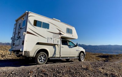

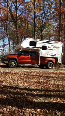

Here's our '01 crew cab long bed 4x4 gas dually hauling a Lance 850, about 2500lb dry weight.
We figure at least 3500lb total payload with camper wet and loaded, 2 of us, food, gear, and tools.
Honestly for your camper I would think a 2500 w/hemi would be adequate, but I also believe that you can't have too much truck.
We've struggled with the same question, gas vs diesel, because I'd love a new Ram dually. The Chevy's a great truck, just old. I'd personally prefer gas just because that's what I'm used to, but gas duallys are unicorns at least around here. It's also not a daily driver so diesel seems like overkill for us. But it would be nice to have that extra grunt, especially when we get the chance to travel more and hit some mountains, it's a pretty big load.
Good luck and fun travels either way, I will be interested in what you choose and your experiences!
Had to add, this beast only gets about 7-8 mpg loaded!

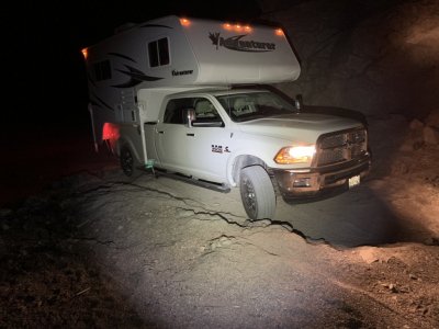

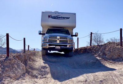

4x4 2018 Laramie LB is the only way I could ever carry my camper 10 mi on some questionable dirt roads and get to my nice spots. Cummins torque is sweet along with the Aisin trans. My camper is an Adventurer FB86 2012, 2300lbs dry, 40 gal water, two 6v batteries,31 grey and black. 2 wheel drive could never be a consideration for a camper unless you are a KOA only camper.
Oh, the side steps are going to be sold somewhere, they were an issue along with the front camper tie downs which need to be changed to the ones that are higher up for clearance.
