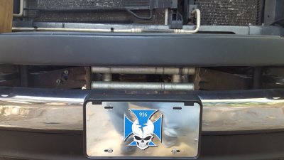

It fit. Installed it today.
Now to find a winch that will actually work with this mount. Open to suggestions...
