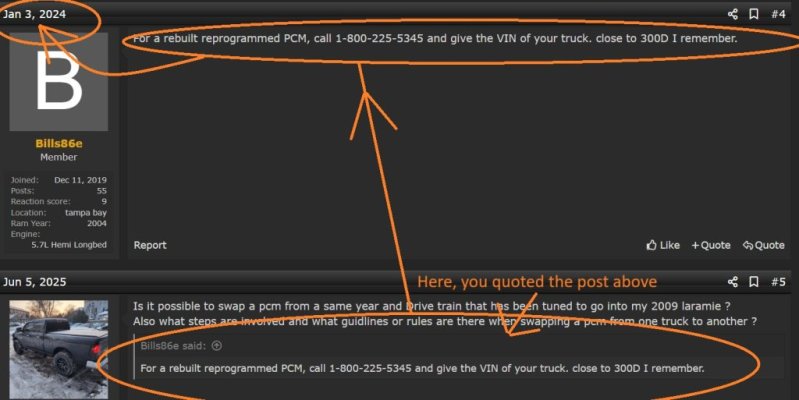

Just curious, but the guy you quoted, posted that answer, to someone else, a year and a half ago... His answer, that you didn't like, occured a year and a half before you asked the question? Or am I missing something?
Anyway, to answer your question, Yes, another PCM from the same year will swap right in, physically.
But, it needs the VIN and vehicle information programmed into the PCM or it won't work.
AlfaOBD has the option in the Engine Computer - Active Diagnostics tab, to program the VIN and to write the vehicle information to the PCM. I can't verify that it works though, as I have not actually done it myself.
Or, alternatively, aftermarket companies, like the one in that year and a half old post up above, can program it for you.
No the guy replied to my PCM question with a sales pitch answer. Like , "Here call my 1800 # and pay me to unlock your pcm" Aaahhhgoooof !

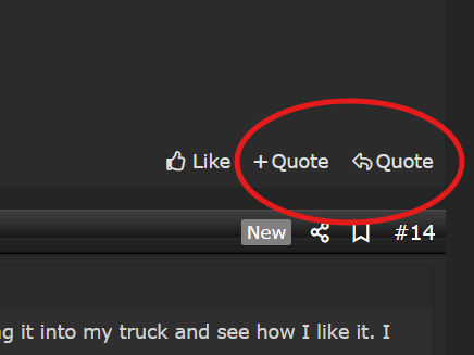

The last time that guy was on this forum was a 11 months ago, so probably was not replying to you.
Maybe you are new to forums and aren't familiar with the function of these two buttons?
